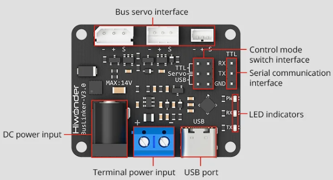

The wiring diagram for the servo control board is shown below. Power the board with a 12V power supply and connect the servo control board to the computer using a Type-C cable. Connect the magnetic encoder servo to the board.

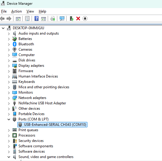

Press Win+R to open the Control Panel, type devmgmt.msc, and open Device Manager.
Click Ports to view the port number; here, the port number is COM10.

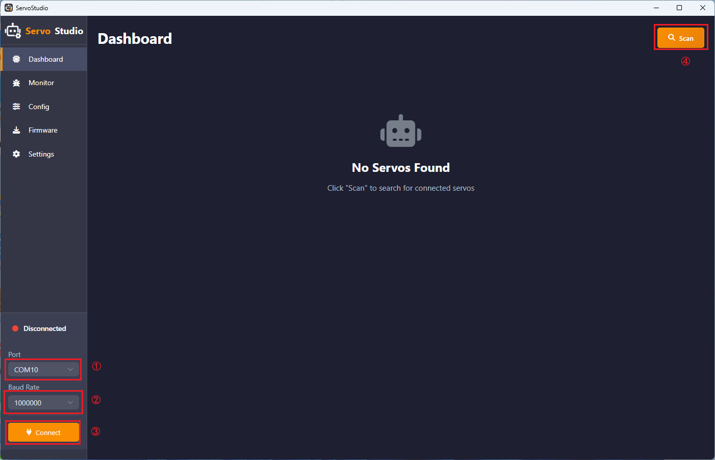

Double-click to open the software .
Follow the steps:
Change the Port number to the one found (in this case, change to COM10)
-> Set the baud rate for HX-30HM to 1000000
NOTE
The baud rate may vary for different magnetic encoder servos. Refer to the corresponding model's user manual for specifics.

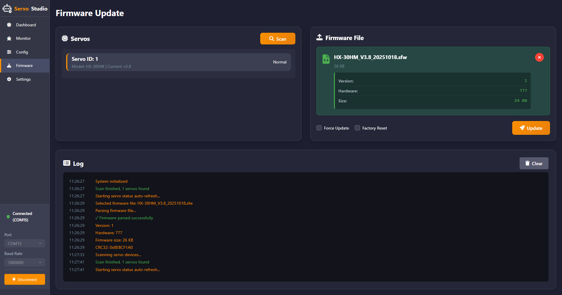

-> Click Connect -> Click Scan

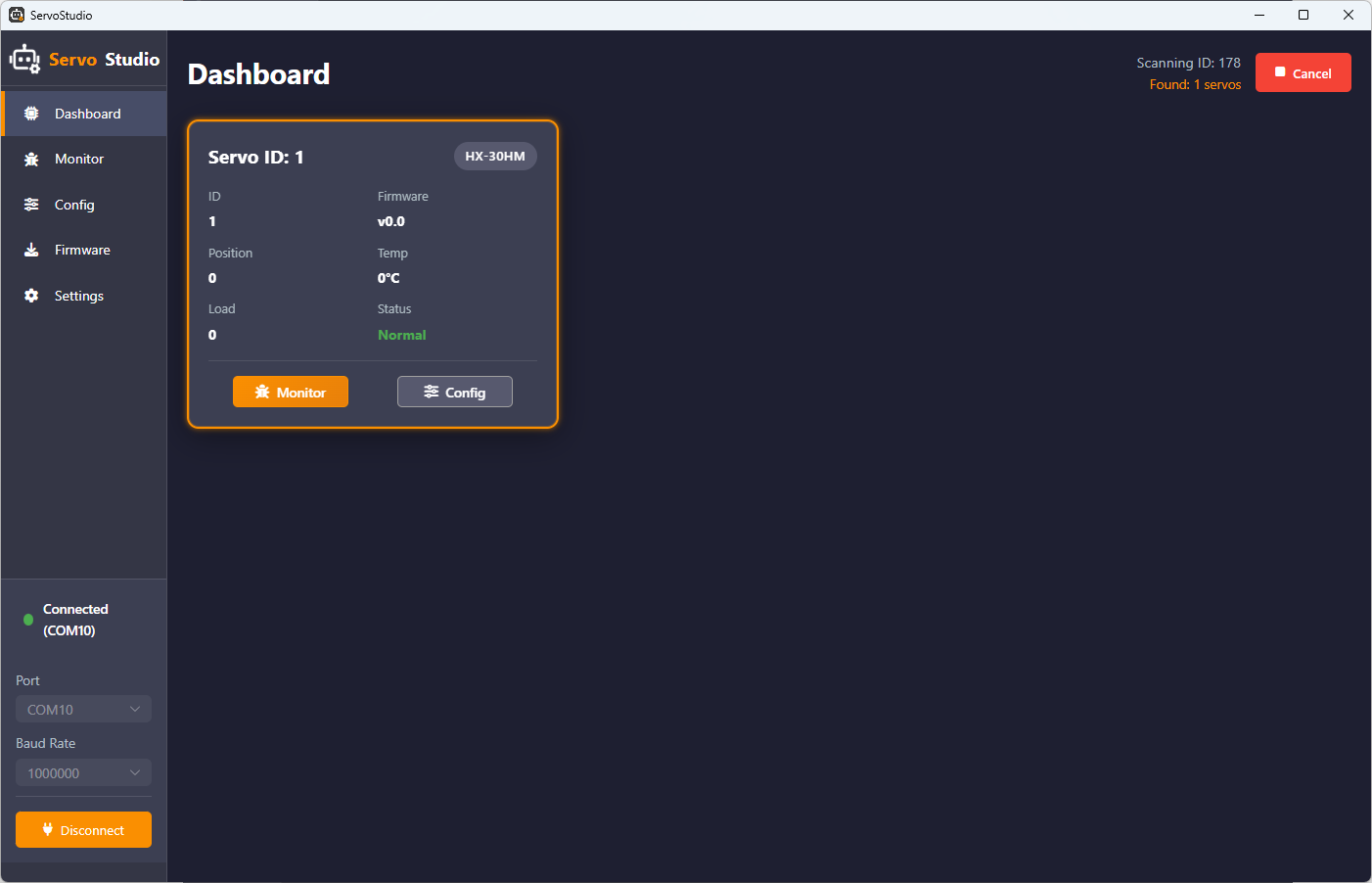

The system will scan all servo ID. If a servo is detected, a servo control interface will appear, as shown in the image below.
NOTE
If no servo is detected, unplug and re-plug the servo for testing.

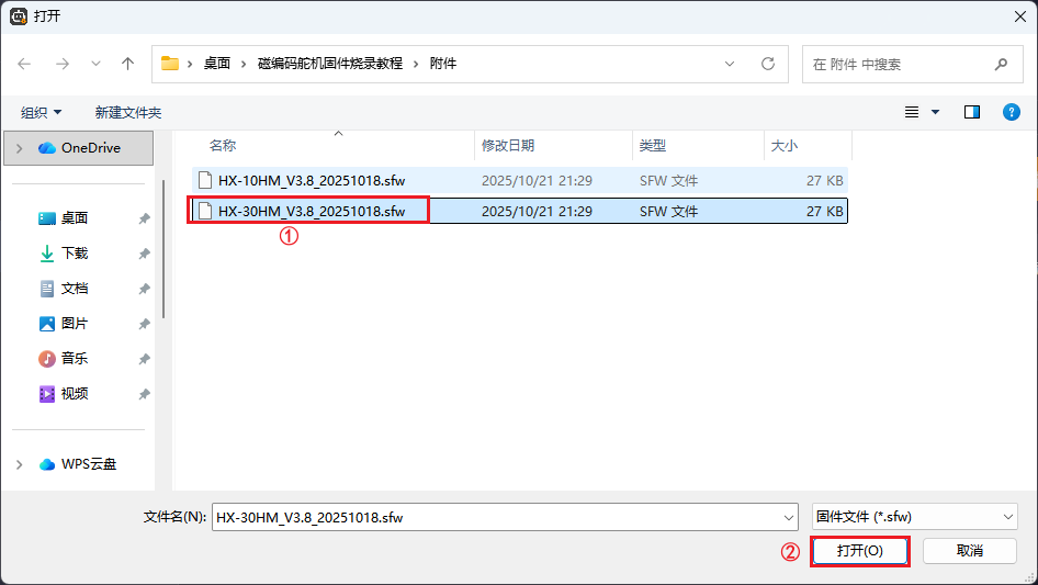

Click Firmware -> Click Click or drag firmware file here..
Click the HX-30HM_V3.9_20251023.sfw firmware package -> Click Open.
Click Force Upgrade -> Click Upgrade.

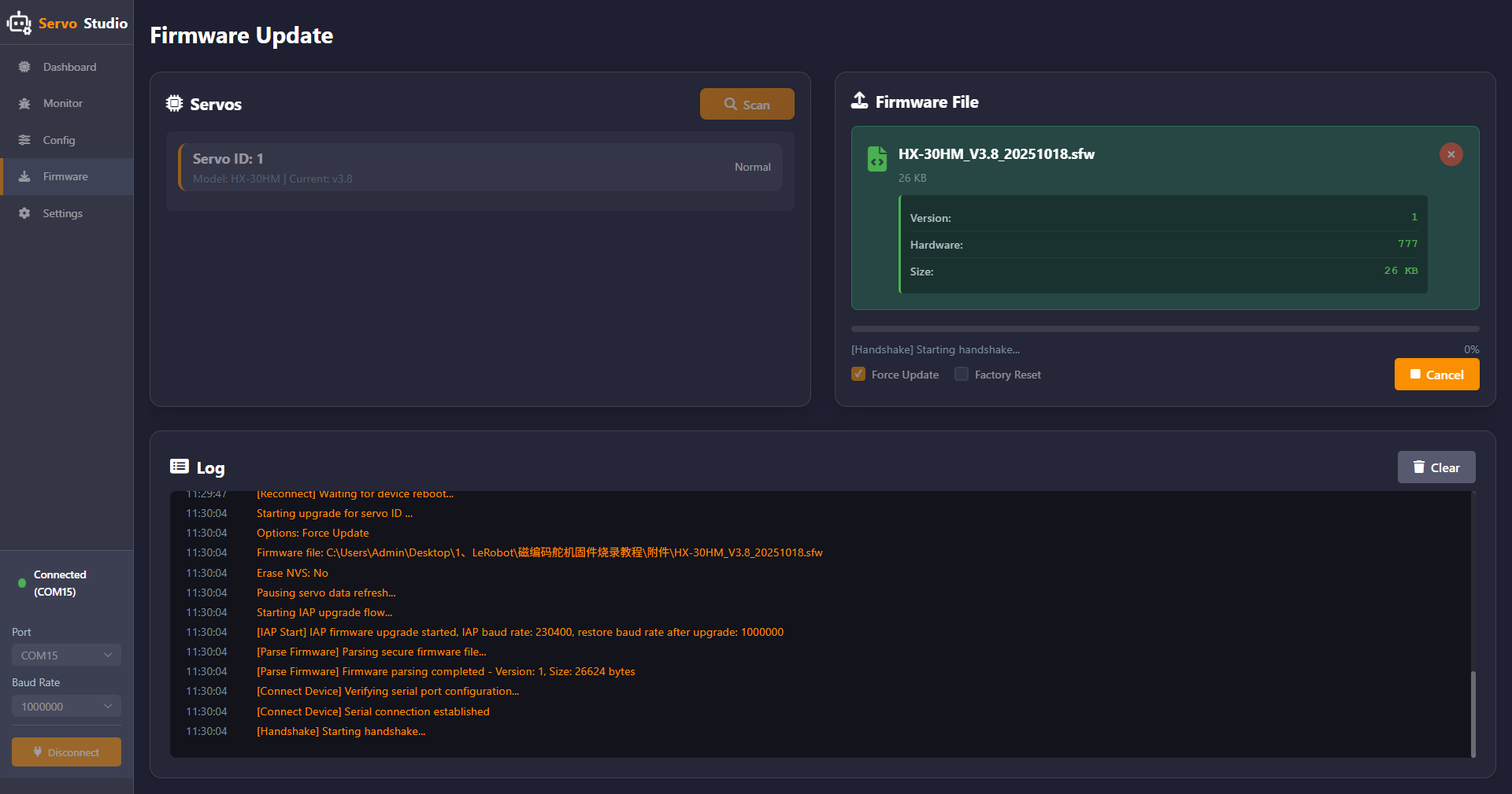

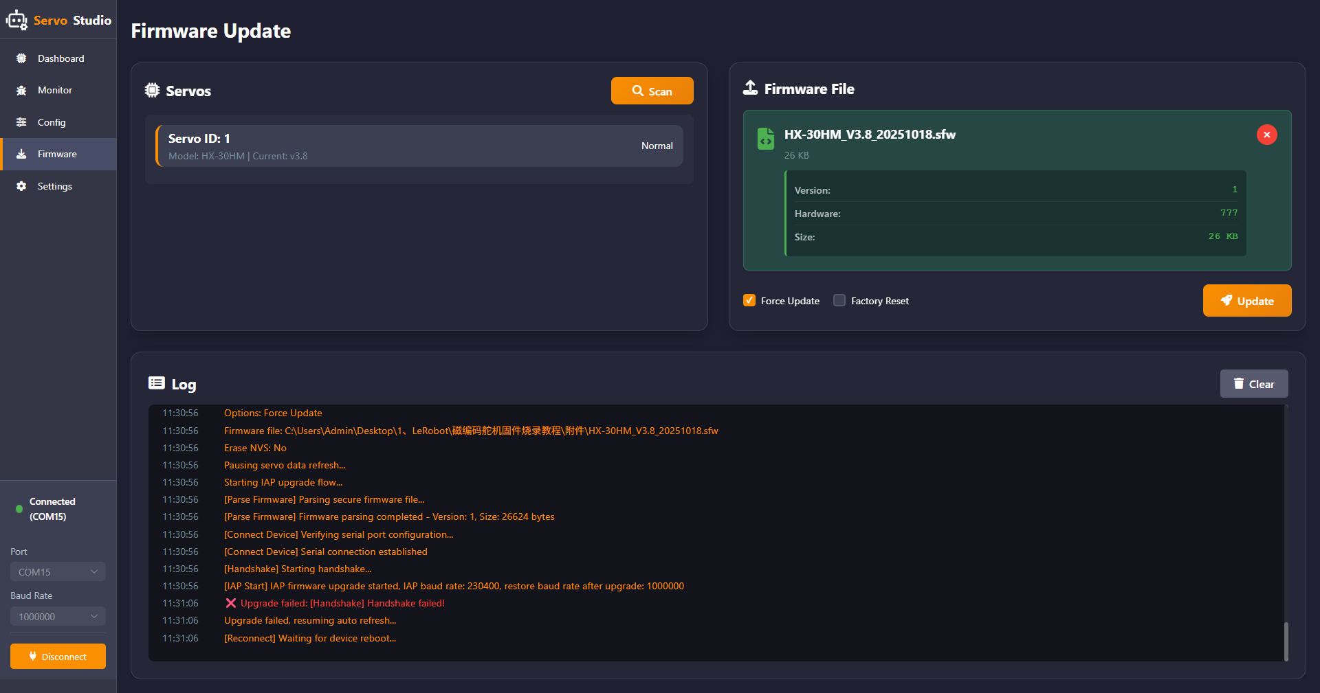

When the following screen appears, it indicates that the flashing process has started. At this point, unplug and re-plug the servo wire.

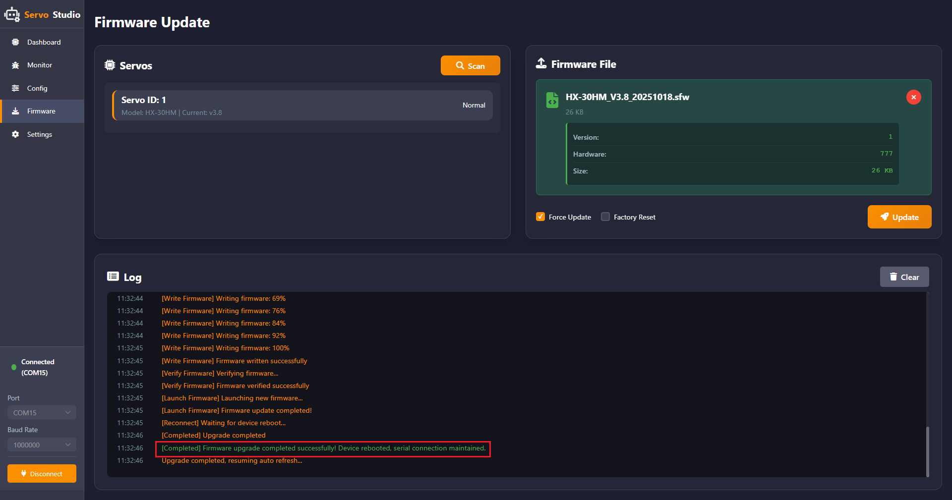

When the red box appears, it indicates the servo firmware has been successfully flashed.
NOTE
If a "Handshake Failed" message appears (as shown in the image below), follow the steps in the documentation to proceed again. Click "Upgrade" and retry the firmware flashing process.
